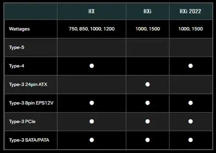

Now I'm finally aiming to finish this build and I'm looking at these cables and trying to make sense of Corsairs compatibility chart. The current table of theirs only seems to cover the AXi 1600 model which is different (I think)
what confuses me here is there's an HXi and HXi 2022 on the table and it's unclear how to tell them apart?

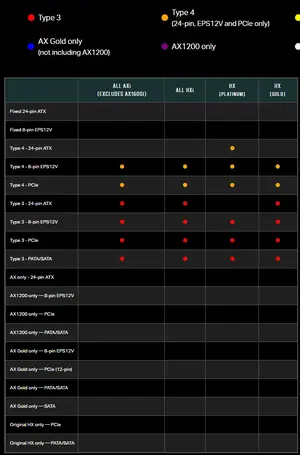

But looking at the legacy table, I'm pretty sure the cables I had for my AX1200i are compatible with the current HXi1200
I narrowed down the relevant part of the table though and it looks like it might be the same cables for both the HX1200 and HX1200i I have here, depending on if the HX1200 non i is gold or platinum which I'm not sure, worst case I do a swap with the wifes machine right
