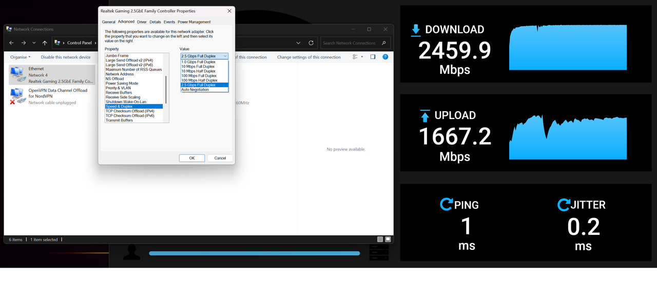

Well turns out that led me to a solution so thanks!
Under Network adapter > Properties > Configure > Advanced > Speed & Duplex it was set to 1Gbps Full Duplex. Set that to 2.5Gbps Full Duplex and now results are as follows:
https://i.postimg.cc/wvf7WpTQ/OST-results.png
A step in the right direction banana Should I expect to see 2.5Gbps up as well as down?

Ah right sorry I understand what that is now. I had it set on 1Gbps Full Duplex so I've now changed that to Auto Negotiation as suggested.
Any idea's why I'm not getting the full 2.5gb upload? My new switch has just arrived so will connect that up and unbridge the LAN ports to see what effect it has. What kind of speeds are realistic when transferring to/from the server if the shares that I transferring to are using the Samsung NVMe drive as Cache?
