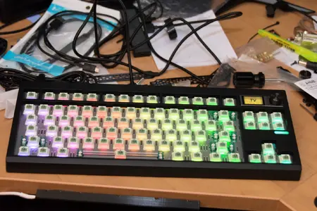

KB arrived today in a relatively beat up box, but appeared undamaged. Pretty standard fare with KB, cable, switch/keycap tool, and manual which strangely enough doesn't actually specify a website for downloading the software (VIA for mapping keys, and the LCD tool for the display) but instead directs the consumer to "get it from their distributor"? (One of the youtube reviews had links to the file....)
The case pretty much came apart the same way as the GMK67 I showed earlier, but had a much thicker plastic membrane than I remember and I was having difficulty forcing the 5 pin Duhuks into the slot. My solution was to use Gateron G Pro blacks to break in the socket (only 3 pin, and beefier metal pins) and then install the Duhuks afterwards.
As stated in my description of the switches, there's a lot more LED action going on here when compared to the Oil Kings.
These keycaps were purchased because I thought they were shine-through.... they're not, they're just translucent bodies. OTOH, the lettering is a much higher contrast than the board I had in there previously (the blue samurai) so it's definitely an improvement, but I'll probably keep hunting for a decent shine through set.
The sound profile on this KB is significantly different from the RK84 boards, but not necessarily in a bad way, just different. It still sounds like what I'd consider to be "thocky" but it's a much more pronounced bottom out than the RK boards. These switches have a heavier feel to them (reviews on the Oil Kings suggest they overstate the bottom out weight of 65g so maybe these are closer to that) and I do notice the different "throw" to the switches, but again it's not bothering me all that much so I suspect my dislike for the cherry speed switches was more about the weight of them than the throw.
As far as the KB body goes..... feels substantial enough, and has both a volume dial (press for mute) and a mini-LCD that displays date/time (pulled from windows) or you can upload animated gifs.
