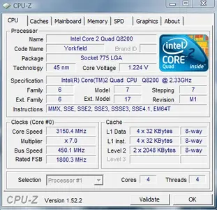

I have never overclocked before, was curious and wanted to try it.
Q8200 on ASUS P5Q PRO TURBO. RAM is 800 MHZ. All voltages standard except Core voltage at 1.25 V. It is running stable at 3.15 GHZ (450MHZ x 7).
Is it just dumb luck?

Depends how you define "stable"...
If you've ran LinX or OCCT or Prime95 for at least 6h without errors, then I'll agree that it's stable. And if that's the case, good job indeed.

Very nice overclock. Only thing that sucks is the low multiplier. What's your temperatures?
Anyways, here's my definition of stability.
4 to 5 hours of OCCT
30 passes of Memtest test #5 and 2 passes of overall Memtest
Can run Folding@Home without crashes

That's pretty much what I do too. I usually do Memtest first. And if it passes then I'm off to the races !
