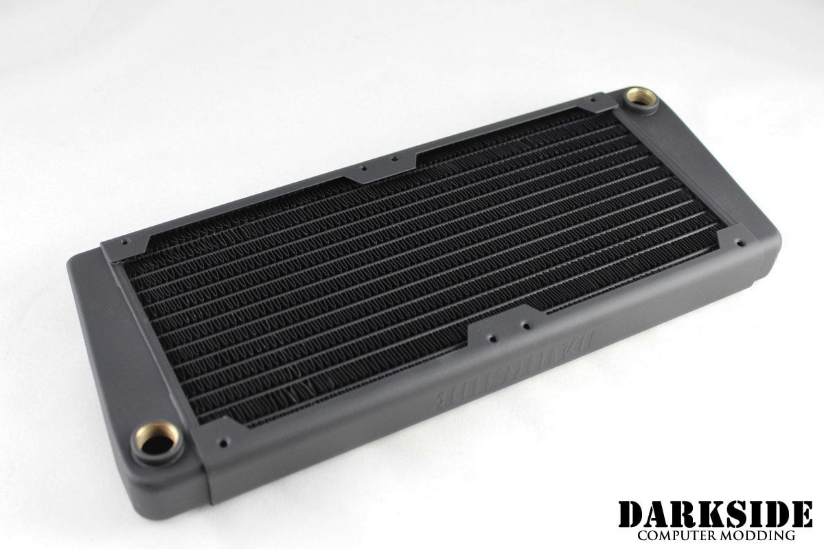

Good old Daz has Darkside branded crossflow rad for a 240 at 55.00.
They're inexpensive. I have a 360 vertical crossflow up front and a conventional 240 up top.

You do lose performance from a crossflow radiator but they are convenient. Push pull isn't really worth it. But slow fans on a thin radiator is a nice setup. If you have enough rad space you get peace and quiet and good temps

Someone did a comparison of crossflow to conventional rads. Damn if I can remember. (old age).....there was a difference but it wasn't all that bad. My 2 rads from Daz are thin with low fpi count. I run my rad fans at 500 rpm (idle) up to just under a 1000 rpm under load. Very quiet. They're also a lot easier to keep clean because of the low fpi. Also easier to fix bent fins. I used to run a thick rad with a high fpi but it was a lot of noise and a lot of work to keep clean.
