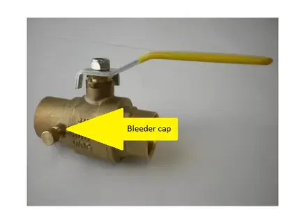

The valve you are talking about probably has a little bleeder cap on it too, to drain down the hose bib all the way to the valve. The bleeder (drain) cap should be on the side the hose bib is on. Don't fn-drop the cap!!! lol. To drain it close the valve, open the hosebib tap, drain into bucket from the bleeder cap, replace cap, close hosebib.

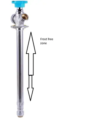

All those hosebibs are frost free. You don't want the frost getting past the end of that frost free zone.
The actual shut off is at the bottom of the lower arrow. If the valve is installed correctly, slightly sloped away from house, it will drain every time you close the valve. Little cap thing on the top is the vacuum breaker to allow the water to come out.

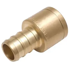

Ya I don't have any of those I have 2 normal valves on the cold water linen leading to outside one inside the basement one outside and there is only shut off on my kitchen sink not even on the bathroom. which sucks but at least it's all copper no galvanized anywhere, The thing I don't like if I want to go Pex to fix anything I have to use a Sharkbite "I think" cause I have never seen any type of crimp for going from copper to Pex
