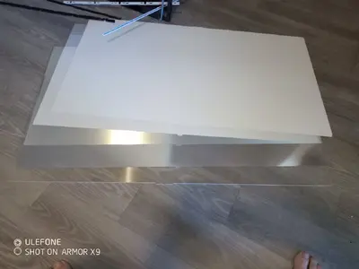

I pulled aprt a LED tv ( rca RLED5078 a-b) so I could check the LED strips but I didnt find any here's the thing though when I fired up to tv the RCA screen showed up for a few seconds also it was a TV from my work place so it was working , I am not sure if this TV actually has LED strips , when you pull off every thing you get to the White plastic there are two layers of then then there is a semi see through reflective plastic piece then under that there is a total reflexive silver piece then under that there is finally a thick one side is mildly abrasive piece that is see through oh I do have a rant unrelated I wished my cell wouldn't have hardcoded its name on all my photos
At a glance those all look like pretty standard diffusion panels to me. light are usually behind all of that stuff
strange because under all of that is the metal frame no LED panels I actually even separated all of those plastic pieces to be sure the LEDs were not stuck in between hehe and here I thought that I had something to do today by testing the LED panels
shadow there is no LED's behind that ??? I ask because that just looks like the light diffusion layer you have there, are their LEDs hiding on the bottom/top/sides that would light that layer up maybe the only way I could see that lighting up the screen
ya, then it has to be on the bottom/top/sides light source
I contacted someone on ebay and found that they are on the sides they are very small but very bright all I needed to do with plug it it and power it up it light up and I quickly found the one burnt out led now I am not sure where to get a replacement of either the whole strip or just the one LED anyone e know where to find parts
