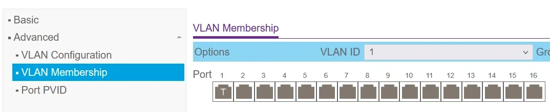

So finally got VLANs working. Tried like 10 years ago and gave up. Had a whole lot of trouble getting OPNSense, Netgear switch, and Ubiquiti switch to play nice.
I originally setup 1 VLAN for IOT, VLAN20. And eventually got it working. But OPNSense suggests that all traffic on the uplink should be tagged. But if I tag the uplink, I lose access to the gateway. Found a post somewhere stating I'd need to create a new VLAN in OPNSense, and reassign the LAN interface to use it. Did that. Configured switch to move PVID for most ports to the new VLAN. All working except the AP. Sigh.
I changed the PVID for the AP to VLAN10 and untagged it. AP is up. But wifi is down. Ended up having to change the default wifi network from VLAN10 to native network. This just doesn't make sense to me. So now VLAN1 (native) literally has no devices except the OPNSense gateway. That doesn't seem right but whatever, everything is working now.

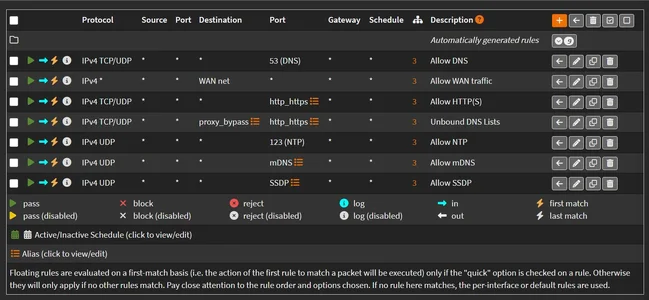

Locked everything down tighter than fort knox. Or at least I hope so lol. Took a bit to figure out how rules actually work in OPNSense. But I think I got it. I've deleted the 'pass all traffic' for all VLANs.
The floating rules apply to all VLANs. This is just basic stuff like passing DNS, HTTP(S), traffic to the WAN, etc
