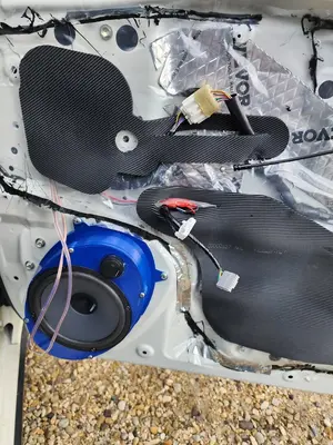

Front doors. Hertz H165s. I just printed an adapter to change the 6x9 adapters, I made before, to fit the 6.5 + tweeter. I ran another set of wires for the tweeters. Tweeters and mid will both be amped separately. BUT they'll share the same DSP signal. I think the DSP should be able to overcome any issues I have w/ the amp's crossover.

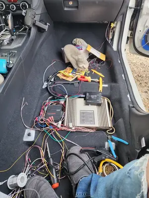

Spent probably 7 hours out there wiring today. It ain't looking pretty so far. But I am doing my best to cable management. But 8 channels, 2 amps, the level converter, relay, DSP, and other stuff there are SO many cables.
Level converter is wired. Amps are mosly wired. Relay is wired. Still need to tap fuse box, run tweeter wires under carpet to amp. Plus DSP wiring.

Where I'm at so far. So many wires.... Anyways just need to wire the speakers. It is raining tho so will need to wait for it to stop so i can fish the tweeters.

Also have noticed that the rain drips on to my speaker magnets since they are way bigger than stock, and then it drips in to vehicle. So I'm going to have to make some baffles for all the speakers to deflect the rain away from them.
So the speaker rain deflectors I made do in fact work great. We had on /off thunderstorms today and no water dripping in cabin.
