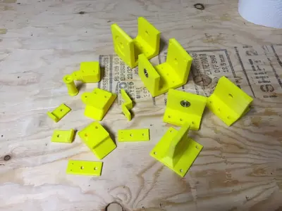

I'll try to remember to post a pic or two of the parts I've been making for my CNC router.
