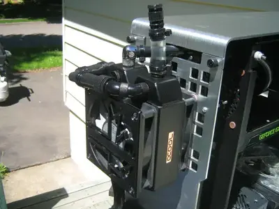

You can also extend the size of your reservoir for the bleeding process if you've got a spare fitting left over.... just attach a length of hose to the fitting and put it where your top plug currently is.
(Essentially what I did here with the top port on this rad).
