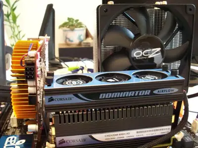

There good pics and I like that Video Card it looks very nice. I would be willing to say that Vid Card HS will cool the cards RAM sufficiently as it looks like it will be getting nice airflow whereas the reference stock cooler has them covered with thermal pads but no flow.
Excellent vCore there, nice and low and should give you a lot of headroom. It will be nice to see some load temps and vCore in OS and a run on OCCT to see how your vDroop is.
Yep....then...pour the coals to 'er. 4GHz+ baby. :punk::biggrin:

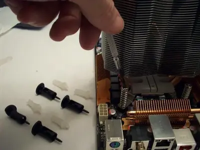

As some of you know I've been experiencing some heat issues in my attempt to overclock my new rig but hitting 79C at a mere 1.35V-core I knew something had to be done. Well my earlier attempts to use the Thermalright bolt-thru kit got sidelined because I just couldn't fit it on my first attempts, but these heats made me redouble my efforts as I wanted lower temps.
So here goes a plethora of shots I took today in my journey to cooler climes.
Some suggested maybe my pushpins were not secure..nope they looked great
