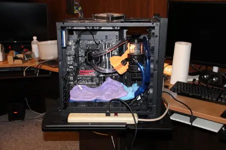

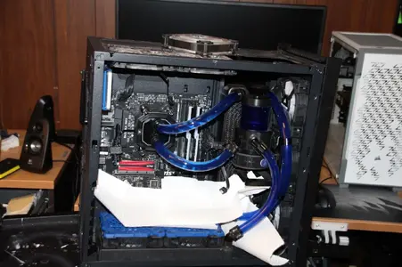

Loop pre-liquid. Pretty sure both the PSU shorting plug and the little G1/4" threaded funnel came with a Primochill bay res.
Loop is filled without any obvious leaks so the towels are gone (mostly for major leaks if they occur at the start) and replaced with paper towel for an overnight leak test.
Bit bummed that my EK supreme HK block(s) don't have AM4 mounting adapters available (they have them for the supremacy, but not for the earlier models) but I suppose I can't complain too much, I'm sure I got at least 10 years of use out of them.
edit: oh, and non-staining tubing? I think not..... :)

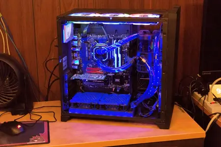

Still got the unicorn puke around the edges (front and top) but straight up blue internally.
Temps are 26C idle and 57C full bore (sp?) but I know I can tweak the fan profile better. It's currently 550 RPM idle and 1730 RPM full load, but previous profiles were 450 Idle and somewhere around 550 max with peak temps around 60c.

Pretty happy with the temps.
PBO = Off Vcore Offset = -.050V
1 hr prime peak temp 70c (average appeared to be somewhere around 55c during the hour). Rad fans tuned for 460 RPM up to 62C, and peaked at 725 RPM. (Case fans set to a fixed minimum rate so 800(ish) for the HDs, and 650(ish) for the LLs.
I'm sure I could shave a few degrees off of the top end, but I don't see the need to sacrifice relative silence for the sake of full load temps below necessary levels.

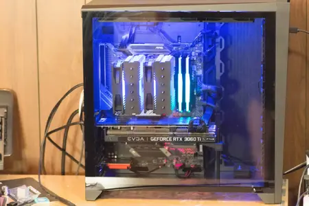

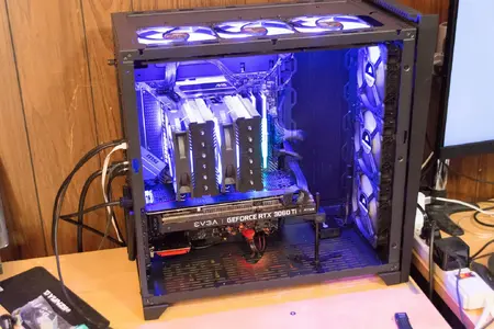

And here's the end of the Lian-li's life cycle with me. Only thing left to do is to pull the TR NVMe heatsink and replace the current 2TB drive with a 1TB of the same model. Looks like I might already have a local sale lined up, but that will depend on how long my back-ordered bundle takes to get in.
I managed to shoehorn in a PA 120SE, but had to put the fans in pull config to clear the memory (not enough clearance to the case side to simply raise the front fan enough to clear the memory). I've thrown an EVGA FTW3 Ultra 3060ti (bought from here) onto it as well as an Intel "Killer" Wifi 6 AX1650 card out of my tickle trunk. I tried to use the vertical card mount, but it was way too tight with the PA in there, and I most definitely wouldn't have been able to install the wifi card.
Should be a decent gaming rig for whoever ends up with it.

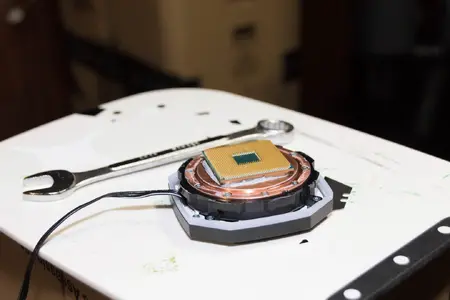

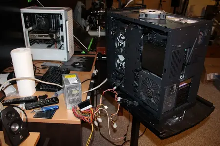

And while we're at it....... taking the loop down did not go easy.... aside from the loop complexity, relatively tight spaces, and the lack of a drain (in hindsight... I should have just slaved a tube into the top of the reservoir and flipped it upside down to drain) there's also this......
Somebody didn't think to throw a load onto the cpu just prior to shut down to soften up the Tim that's been on there for a while. :(
Ended up soaking it in alcohol which loosened it up enough to safely get it unstuck. Fortunately none of the pins were damaged and it's back up and running as if nothing had happened.

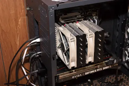

Can't say I'm a fan (see what I did there??? ;) ) of the sound profile of the TR TL-C12C-S 1550 RPM fans which shipped with the PA 120SE. There's a throbbing hum which starts to become evident somewhere around 1200 RPM (they seem to be running in the 1350 RPM range to keep the 5900x at around 63C under load). Not sure if it's normal for them, or if it's a function of the offset mounting I had to use, but either way, it was irking me so the cooler fans either had to have their profiles adjusted lower (thus leading to higher temps), or maybe a trip to the tickle trunk was in order.......
Pair of Noctua NF-P12 Redux fans are probably just what the doctor ordered.... yep... much more pleasant sound profile under load while providing similar temp results. Lost a little bit of RGB with the swap (it was on the wrong side of the HSF anyways) but that's really the only downside.
