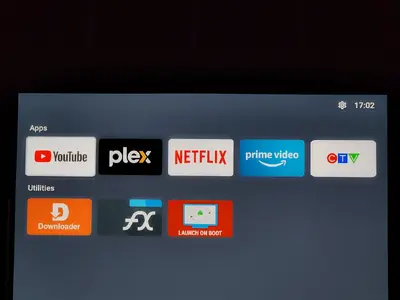

Didn't really use Home Assistant since moving in to the house 2 years ago. Did do a few basic automations for the work shop. But recently did all the living room home theatre stuff as well. My Harmony Hub has a bunch of issues controlling setup properly. And I hate the default FireTV launcher/UI.
Side loaded Flauncher, which is the only other launcher I could get to work. All the other launches dont use basic APK files and I couldn't figure it out.
It is very basic but at least doesn't have all that spam Amazon stuffs down your throat. But there is still no way to set any other launcher besides Amazon to default. So in Home Assistant I use an emulated Roku that i add to the Harmony Hub. It thinks it is sending commands to a Roku, but then I can set whatever I want those commands to do in Home Assistant. So I bind the Guide key on my Harmony to some Roku command, and then I have Home Assistant open the launcher on the FireTV over ADB. Every time I 'turn off' the FireTV via the Harmony, I have Home Assistant open Flauncher, so next time I use it, it is on the right launcher. Been a few weeks and been working perfect.

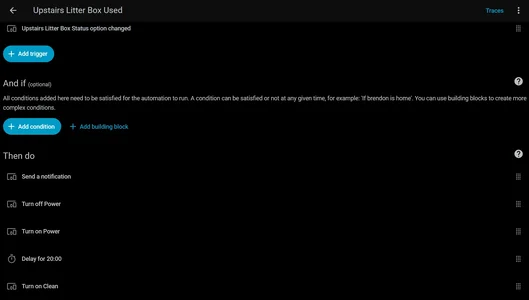

So I wanted HA to send me a notificaiton when used, and allow a longer time before use and cleaning. So try using manual mode. The dumb litter box won't allow me to do a manual clean if its set to manual mode. And it also won't detect if a cat enters or not. After a bunch of tinkering was finally able to get it working the way I want. As soon as a cat enters it, I have HA turn litter box off and back on. This stops the automatic cleaning cycle. Then I can have my own delay done w/ HA. Then do a manual clean cycle.
I think this relies on the cloud still tho. Will have to look in to if other plugins will add local control. Don't want my litter boxes not working if power goes out lol.
