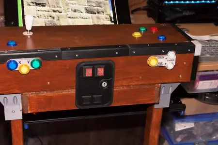

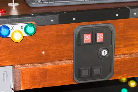

Happy with how that turned out, but it's been attached using gel tape and while I'd like to move it up a bit I'm afraid it'll rip off the finish.... :)
