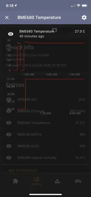

Could also use ESPHome. It has BME680 support. Could probably set it on on an ESP8266 in a couple of minutes.
Gave that one a go but it doesn’t use BSEC library to calculate eCO2 or VOC unfortunately. The Bosch forum had some examples of linking in the precompiled library and through that I managed to get it sort of working.
Not sure why it’s not updating in HA unless it’s plugged into my PC or if I have the web server up (plugged into USB walladapter).
You can add your own libraries and custom sensors to ESPHome.
Yup that's what I was doing. Initially made a mistake by setting it up as a polling component instead of just looping and looping and using the sensor library call back to inform when a new reading is available. It's working now.

Had a problem with the ESPHome devices disconnecting from HA. Didn't fret too long before converting it to the same style MQTT as the Airthings stuff.
Rebuilt it using these two pieces of code:
BME680 code from kriznik - updated it to use ArduinoJson 6 and to build on the ESP32.
miaoski-esp8266co2 - code to read data from a SenseAir S8 NDIR CO2 sensor
The fake "eCO2" from the BME680 seems very sensitive compared to the real NDIR CO2 sensor on the SenseAir and reacts very strongly to my presence.. Basically made a DIY knock-off Airthings Wave Plus (without Radon) haha. These sensors can take several days to auto-calibrate so hopefully things come a bit more in line after a few weeks. Give me time to think about what type of enclosure to build haha.
