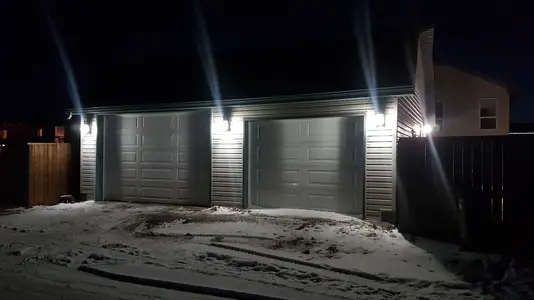

Another idiocy of my garage when they built it in 2000 was no switches in the house for anything garage related.
Installed three Sengled bulbs in my alley fixtures so I can have light out there now.
